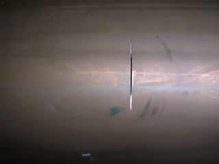

damaged copper cylinder
Here we have purposely cut a 3 inch long slit in a copper cylinder to see if it can be repaired with Easyweld.
