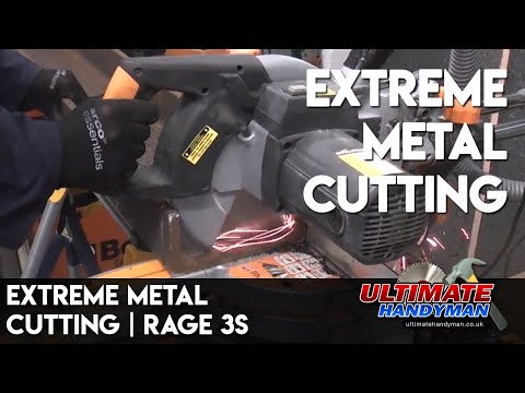

The Evolution Rage 3s 210mm has a maximum metal cutting capacity of 6mm, but in this demonstration I cut through a piece of steel channel that measures 200mm by 100mm and is roughly 10mm thick in places. It’s not recommended to cut such large pieces on this machine as the guard on the machine often impedes the cut, which means doing the cut in an unorthodox way. Please note that at no time during this task did I ever pull the blade towards myself as I was cutting, doing this is very dangerous and should be avoided at all times.
Out of shot of the camera I am wearing ear protection, eye protection and also a full face visor.
