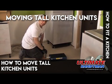

Tall kitchen units or tall kitchen cabinets can be difficult to move on your own, due to the weight and size of the unit. In this video I move the units by using a skate that was made from ball transfer units, which I purchased a few years back from this company- http://www.alwayse.com/index.html
Transfer balls were originally used in the sand pit cover- https://www.youtube.com/watch?v=l2HlC0yl-SU
I then used a motor bike lifter - https://fave.co/3KnRcjx
And a scrap piece of ¾ inch plywood to spread the load.
