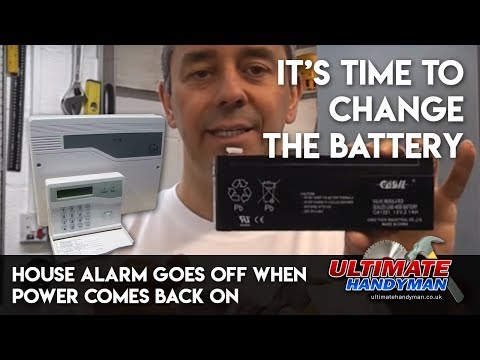

Burglar alarm goes off when power comes back on is a very common problem with many house alarms and in most cases it means that the alarm’s internal battery is flat or no longer working. Rectifying a house alarm sound when power cut is very easy and normally be fixed by installing a new battery, which should cost less than £15 and can be changed in a matter of minutes. The burglar alarm in this video is a ADE Accenta which is very similar to the ADE Optima alarm, changing the battery on these alarms is normally very easy.
