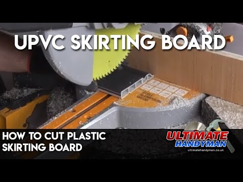

Plastic skirting board, which is often UPVC, can be difficult to cut. In this video I show how I cut UPVC skirting board for a modern bathroom. UPVC skirting board chips easily, so it is essential to use the correct blade and also use a sacrificial piece of wood to prevent damage to the workpiece. I have used the Evolution R255SMS to cut the skirting- https://www.youtube.com/watch?v=kVW_fMgAK6s
The blade used in the video is a Saxton blade with 100 teeth, this requires the use of a reduction ring- https://www.ebay.co.uk/itm/372789655469
