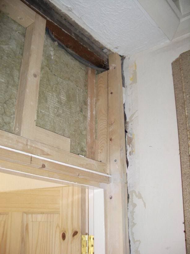

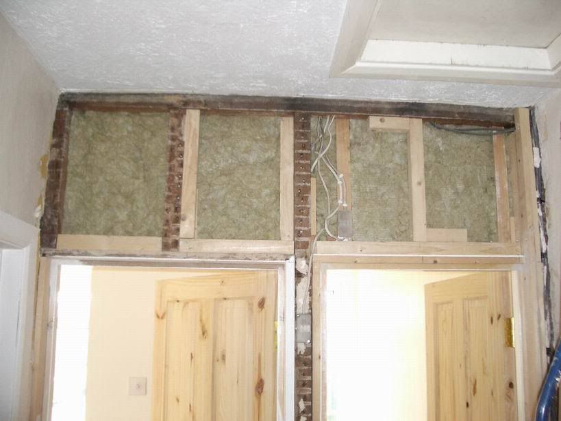

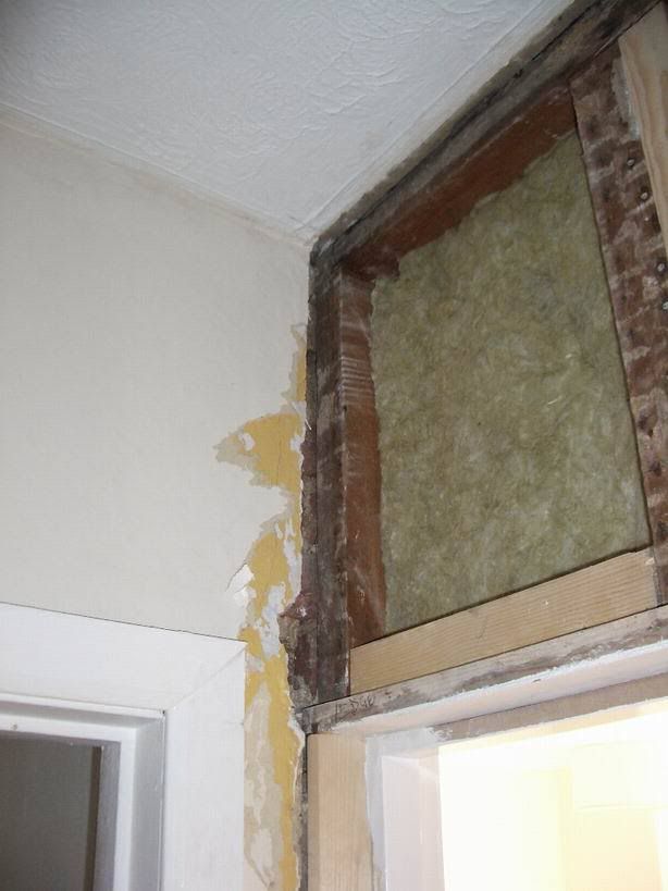

I have the same problem. We've installed a new doorway and are going to put plasterboard up to the edges. The plasterboard sits a few mill below the edge of the doorframe, perfect for a coat of finish plaster.
Will it be okay to plaster up to (and touch) the wooden doorframe? I'm not plastering over it, but the plaster will be touching it?

I'm fitting architrave to most of it, so that's good. But there's one bit where it will adjoin a wooden corner box that hides electrical wires and that will be bare. I guess I'll just have to cross my fingers.
As for taping the joints, I'm still confused. I know you have to tape where plasterboard meets plasterboard, but what about the perimeter - ie where it meets the ceiling or wall, or even where the plasterboard will meet the doorframe or other wood (as explained above)?
Thanks.

Why not put pb onto the box hiding the wires or even make the box out of pb rather than the wood.
As for taping where wall meets ceiling then yes you should do that. I've got a similar task but my ceiling is already platered so I'm filling the join with drywall adhesive. I've also got to plaster upto patio doors and I'm joining this with a sealant (fire/acoustic) that is defined for plaster and hopefully this will absorb the movement with the patio doors so it doesnt crack.

The box to hide the cables is half made up already, but i guess I could plasterboard over it. Not a bad idea. Saves having a glossed corner sticking out!
So Skiiing, do you plaster up to the ceiling and patio but finish marginally short, then fill the gap with your adhesive / sealant?
If I tape to the ceiling, that'll leave one half of the tape visible, and i doubt it would grip to the artex anyway. And then i'd have to redo the ceiling just to hide the tape. There must be a way round this? How about overkilling the screwing of the plasterboard to minimise the movement (i'm assuming movement is what taping stops)?
One of the ends of the plasterboard is going to fit into a chased out section of wall by about an inch. If I were to put the end into this, and then fill the remaining gap with mortar, surely this would prevent movement and cracking and therefore mean i wouldn't need to tape that end?

The tape helps to prevent cracking where there is no plasterboard, like when they are butted up together- there is a small gap. If you have a small gap at the top of your boards where they meet the ceiling, you can just run a length of scrim along the top, only fold it and lap onto the ceiling of the ceiling is being plastered or artexed at the same time, or as you say the scrim will be left showing!

As you know I'm not a pro in this area but here is my opinion. Joining the ceiling I don't think you have and choice but to butt up to the ceiling as close as you can. I've used this when butting up to a surface. It was originally bought to seal boards to studding to accoustically seal.
The r/h side cable box - its weetabix, err sorry chipboard. I wound'nt go anywhere near it with water as it just crumbles. Can't see it all but if its easy I've be tempted to box it off with thick pb if chasing the cables in isn't a possibility.
