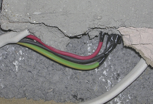

What bothered me was that i dont feel two wraps of pvc tape are adequate insulation on a 32A circuit, the screws were not particularly tight so it seemed like a good point for some melting to be going on.
The shower spur really bothered me due to the lack of protection for the shower and myself in a fault. If we had changed to a normal shower, which the size of wiring dictates is ok, it would blow the breaker when the cooker is on :grin:
Its not the fact that the mess exists its just that it really was not that hard to do it correctly, or if not correctly, a 1000 times safer.
It turns out that the owners had a flood upstairs which wrecked the kitchen and the work was done under the insurance claim.

dave, not saying it is ok.
just that i have seen alot worse.

I actually agree with panlid, whether 2 layers of tape, the cables own plastic coating, or with a plastic cover, its all just the same once a nail is hammered through it!
Theres loads of rubbish workmanship stuff hidden from view!

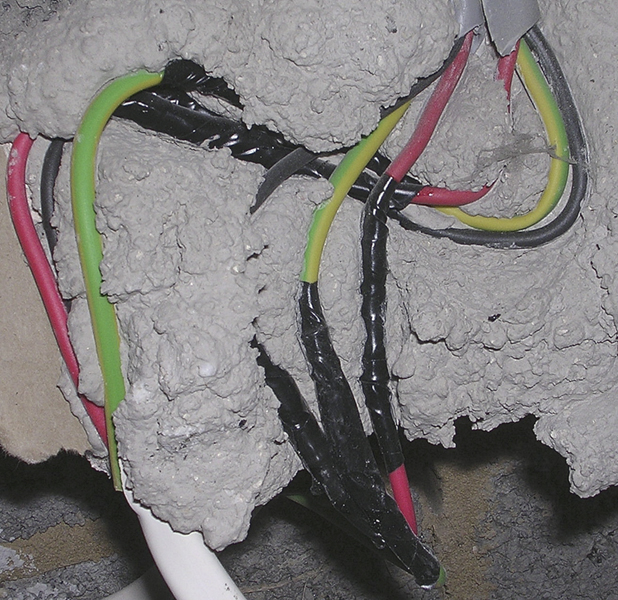

Bit more found after more stripping out...
The 6mm T&E went straight into the bottom of the hob, no connection box or heat resistant flexi. It was quite black & brittle when i pulled it out.
Nice :shock:

at least he used connectors, the numpty in the house before us just used the "twist & tape" method to extend the cooker cable, using 2.5mm2 T&E :?

Here we go again...
Ello, ello, ello, what goes on here...
Stripping anaother wall reveals the excellent twist and tape ring main extension.
I love the state of the wiring in this kitchen, so glad i'm ripping it all out.
