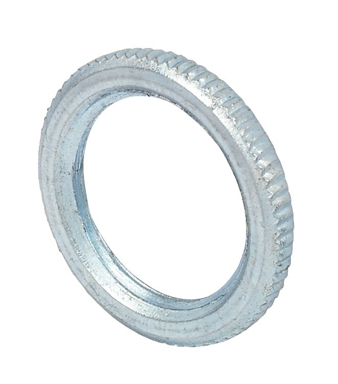

Morning all,
I've got some metal clad sockets which i'd like to join together into groups.
I've seen this done before with brass bushings, this method would be just fine for me, except i'm not sure exactly what I need :)
I've seen these bushings at toolstation.
Male Brass Bush Short 20mm
Do I need the short or the long?
Also, I assume i'll need some nuts, after a bit of googling i've found these at screwfix.
20mm Milled Edge Galvanised Lockrings - Pk 10
Will these do the job?
Do I need some kind of spacer inbetween the sockets to give me enough room to put the lids on?
Anything else?
Thanks
J

The options are to
use a long male bush then a couple of lockrings between the sockets then a lockring and female bush inside the next socket.
or
use two short bushes screwed into a 20mm conduit coupler between the boxes.

Thanks,
Can't see female bush on screwfix or toolstation, but I see other places do sell them.
I think i'll try this option first as it will keep the sockets closer together.
Watch this space... :)

Are these new style MK or old style. If new then either use a male bush ,and lockring with a female bish on the other end , or a coupler and 2 male bushes.
If old style with the lip round the socket then bush lockring between sockets then lockring/female bush on other end.
