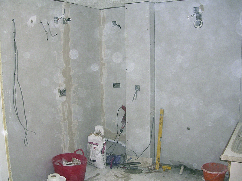

Hi all,
I've done three walls now, taped and filled the joints and corners. It gets a bit easier as it goes on and the result looks great.
The ghostly rings are the flash bouncing off the dust in the air, it looks far better in reality, the wife keeps moaning about the state of her digital camera :grin: :grin:
Thanks to all who have helped me learn a new skill, this is a great forum.
Dave K

That looks ok Dave. I suppose it takes a bit of trial and error to get the mix right. I know mine is right when I can stick the trowel in and comfortably scoop out a bit with the trowel without it running off. There looks like a gap runing down the back of the pillar/boxed off area. I'd fill it with adhesive too.
Are you reboarding the ceiling or just re-skimming it as it it? Again, that gap at the top of the boards could be a problem, unless you are puting coving up. I'm sure you do need to be told that anyway.
Would be interesting to see pics of the finished project.

For the gaps at the ceiling level I would have filled those with some of the board adhesive or the jointing compound but I'm only a DIYer so the spreads will probably tell you the proper way to deal with the gaps :oops:
Out of curiosity, what are all the high level cables for :scratch:
